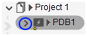

  7. Select the arrow to the left of the component to expand its list of connection ports

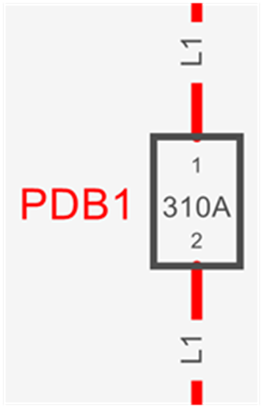

Before following the steps below, we inserted a power distribution block symbol onto a sheet and assigned a catalogue part to the component.
This power distribution block has more than just two connection ports, and many are not yet shown on the schematics.
Following the steps below, we depict a third connection port of PDB1 using the Component Connection Point Block symbol.

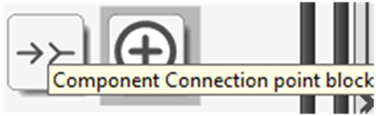

  1. Open the Terminals/Connectors library folder
  2. Scroll to the bottom and select the Component Connection Point Block symbol
  3. Insert it on a sheet
  4. Select the arrow to the left of the component to expand its list of connection ports

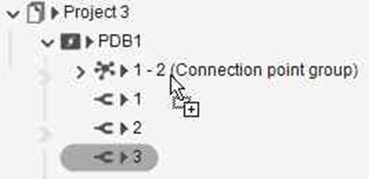

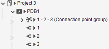

    • If you need the new connection port(s) to belong to existing connection port group(s):
      1. Close the dialog box
      2. Select the project in the tree view
      3. Go to the Show tab and select Components
      4. Select the component, go to the Create/Add tab and select New Connection Port as many times as needed
      5. Select the component, go to the Show tab and select Connection Port Groups while holding CTRL
      6. Click and drag the new connection port(s), one by one, onto the desired connection port group(s) while holding SHIFT
      7. Right-click on the component and Save to avoid having to follow these steps in future

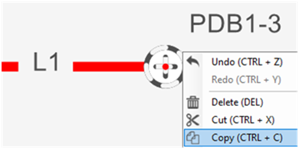

Method 3 – Copying and pasting the symbol, which may be useful for depicting busbar, ground bar and/or neutral bar connections
  1. Copy an inserted Component Connection Point Block symbol which represents a connection port (associated to the desired connection port group, if applicable) of the desired component
  2. Paste where desired. A new connection port of the component will be created, associated to the same connection port group (if applicable) as the copied symbol, and the new symbol will be linked to it
    Note: If you made a mistake and wish to link the symbol with a different connection port, select the inserted Component Connection Point Block symbol and select Link With from the Home tab.
