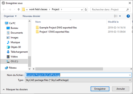

  3. Select the location where you wish for the package file to be created and click Save:
At this point, you should have a package file created, which you can be opened by anyone who has SkyCAD installed on their computer.
