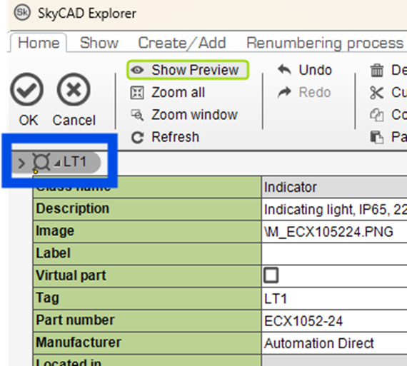

  4. Double-click on any of the symbols to reach the properties of the component
  5. Fill out the Part number property (mandatory) and other properties (optional).
    Side note: if you would like to add a property, see the Catalogue Tools tutorial.
  6. Select the heading of the component
    go to the Home tab and Save
