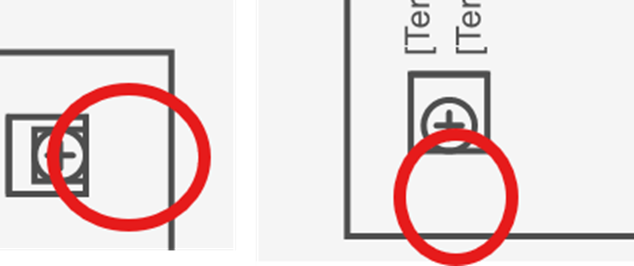

  8. If you end up with an offset between a terminal and the border of the block:
    1. Right-click on the entire block and choose Explore block
    2. Set the Contour offset property to 0
    3. Close the dialog box
