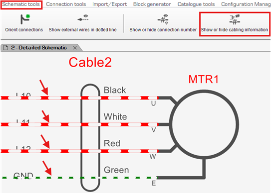

Cable wiring information can also be hidden by selecting the connections associated to the cable, going to the Schematic Tools tab and select Show or hide cabling information:
This will hide the Black, White, Red, Green text in the example above.
