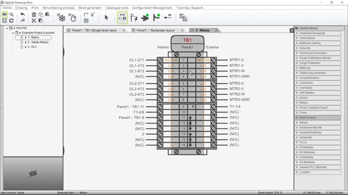

If you need to show a graphical representation of the connectivity of a terminal strip, using the terminal strip layout is the best way to do that.
By default, a terminal strip layout shows:
  • Terminal strip name
  • Terminal strip location
  • Terminal strip description
  • Terminal numbers (sequential by default, but can be overwritten by exploring the terminal strip properties, checking the Allow terminal numbering property, closing and re-opening the terminal strip view, then changing the values in the Name column)
  • Net numbers (orange text)
  • Connected elements (by default, Interior on the left and Exterior on the right)
  • Terminal bridges (terminals 11-13 and 14-16 are bridged in the image above; see this tutorial for how to add bridges)
  • Presence of fuses (represented by an “F”; see terminal 9 in the image above and this tutorial for how to add fuses)
  • End stops, separators, groups markers and other components
