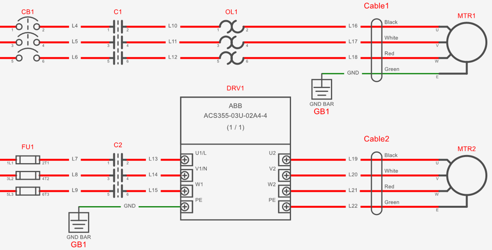

Workflow example:
To better understand the concepts, check the schematic in the image below, showing two motor starter circuits.
To draw these circuits, symbols and block were inserted from the Symbol library.
Notice the same contactor symbol is used for both circuits.
When added to the project, these contactors were named C1 and C2 respectively, due to the Root setting in the Contactor class settings and the numbering format used by the Contactor class.
The same numbering logic applies to all objects (cables, motors, drives, wires, etc.).

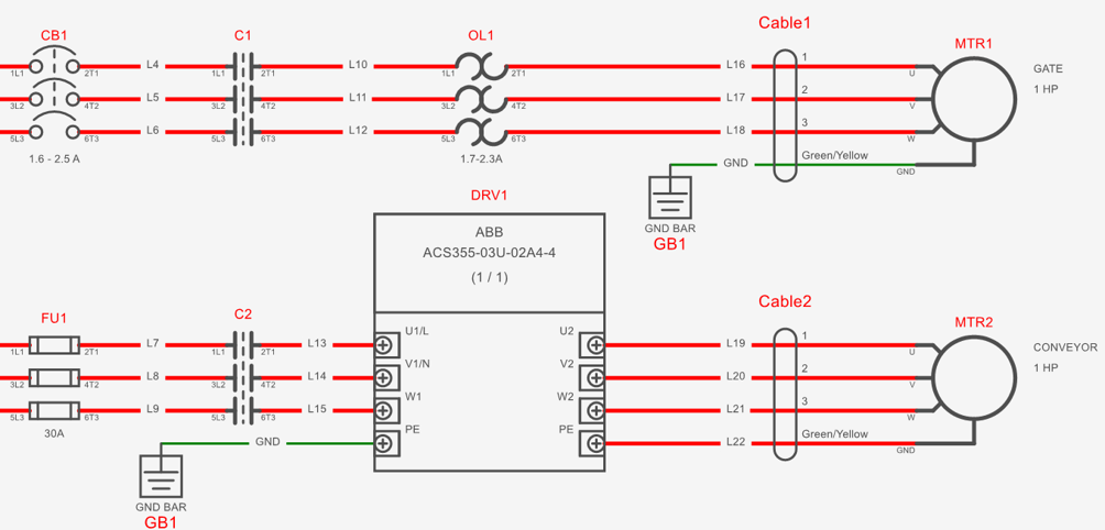

When the drive (DRV1) block, created with the block generator, was inserted onto the sheet, the catalogue part (ACS355-03U-02A4-4) was automatically assigned to the drive.
The other components do not have catalogue parts assigned to them yet.
Once catalogue parts are assigned to all other components, the pin numbers may change, cable wire numbers/colors may change, and additional information (e.g. current, HP, etc.) may be displayed.
